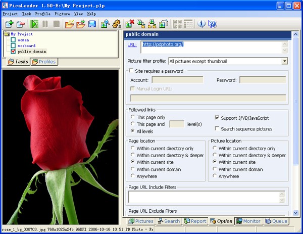

| 1. |
When you first run, PicaLoader will show Welcome window,
you can select to create new project or an open exist project. |
| 2.
After open an exist project or
create a new project, you can select New Task from main menu or by pressing
button on
Toolbar
to create a new task, PicaLoader will
pop up a wizard dialog, with the task name listed as "new start url
1". You can modify the task name, enter or paste the Start URL,
select picture filter Profile, etc. |
| 3.
If you need, you can modify the
task option with the Option tab.
